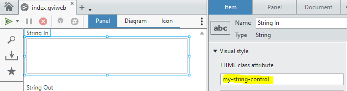

First find a control in the WebVI and in the HTML class attribute configure a unique class to identify the control in the page. For example add the class my-string-control to an exisiting string control:
