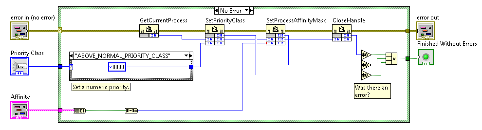

Coding that exemplifies how to set the priority of an execution.
Description
This code consists on how to set process priority and affinity with Windows API calls. Sometimes it is useful to set a higher priority to a specific thread, so we can use this method to do so. Also, we can specify which CPU to use.

1. Choose the desired priority
2. Select the affinity
3. Run the VI

Just a quick note for using this VI: When I initially ran the VI it immediately crashed LabVIEW. This was caused by the Call Library Function Node being configured to use a "c" calling convention. By switching all of the call function library nodes to use the "stdcall (WINAPI)" calling convention, the code ran correctly.
GriffinRU
Member
Member
on
True for LabVIEW versions 2010 and higher.
It is good practice to know exactly which calling conversion to use with given DLL but sometimes you can miss that switch and "c" calling is LabVIEW's default.
Thank you, for your feedback.
