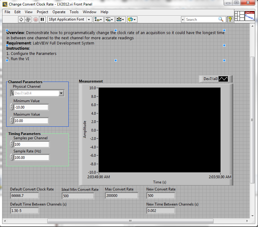

The example is to demonstrate how to programmatically change the time of the convert clock
Description:
Since the default of the convert clock of the DAQ is often faster than necessary, it wouldn't align with the ocassional
times when the user wants to have the longest time between the channel as much as possible for more accurate readings
because it would allow more time for the signals to settle before taking a measurement

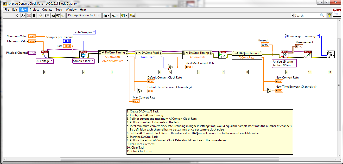

The actual rate may be a little higher due to limitations of the clock generating hardware.
To account for that, instead of using the Rate control value to calculate the Ideal Min Convert Rate, you can use the "actual" sample rate. Just place a Sample Clock > Rate property in step 3 and use its output to both, verify the actual sample rate and calculate the Ideal Min Convert Rate. See the snippet below.
