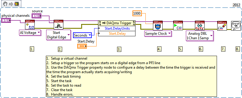

This VI demonstrates how to setup a task that will start a specified number of seconds after a trigger is received.
Description
In this VI, when a trigger is received, the task can start after a programmable delay. This VI can be changed to delay a specific number of ticks or sample clock periods.
Requirements
  • LabVIEW 2012 (or compatible)
  1. Wire your trigger/input output lines to your hardware and select the appropriate lines.
  2. Specify the number of seconds/ticks/sample clock periods to delay the start of your acquisition.
  3. Run the VI.

Can this set the delay time to about within 5µs, or does it depend on the DAQ deck, and if so, which one can realize this goal?

Apparently this doesn't work with CO Pulse Freq. ( Specified property is not supported by the device or is not applicable to the task. Property: Start.Delay)
Then the initial start delay can be used, and may be made not only initial, but for each new serie of pulses : This property can be found under the DAQmx Channel » Counter Output » General Properties » More » Enable Initial Delay On Retrigger. (for models with the STC3 Timing Engine)
