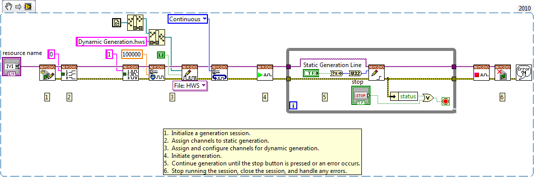

This example demonstrates how to use the HSDIO API to configure some channels for dynamic generation while simultaneously configuring other channels for static generation.
Description
Use the resource name control to select the module you are going to use before you run the VI. Use the Static Generation Line button to select whether the line configured for static generation is in a high or low state. Use the stop button to stop running the VI.
This VI was written using LabVIEW 2010 and NI-HSDIO 1.6. The zip file contains the VI as well as the hws file that is used for the dynamic generation. The hws file was created using the NI Digital Waveform Editor and should reside in the same folder as the VI.

1. Use the resource name control to select the module you are going to use before you run the VI.
2. Use the Static Generation Line button to select whether the line configured for static generation is in a high or low state.
3. Use the stop button to stop running the VI.
