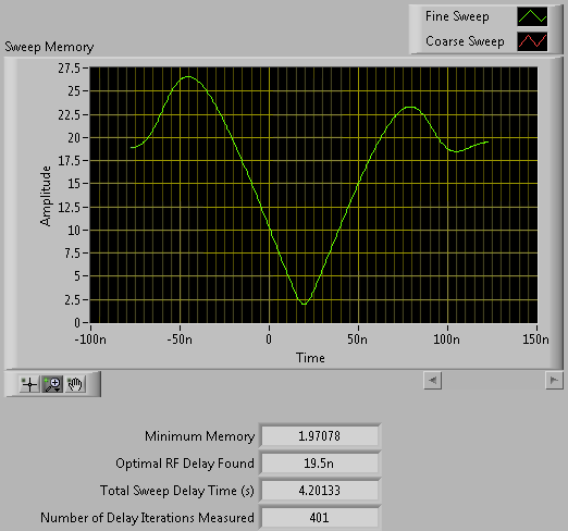

- In Fine Sweep Mode, you should see the AMPM sweep results under the Sweep Information tab:
