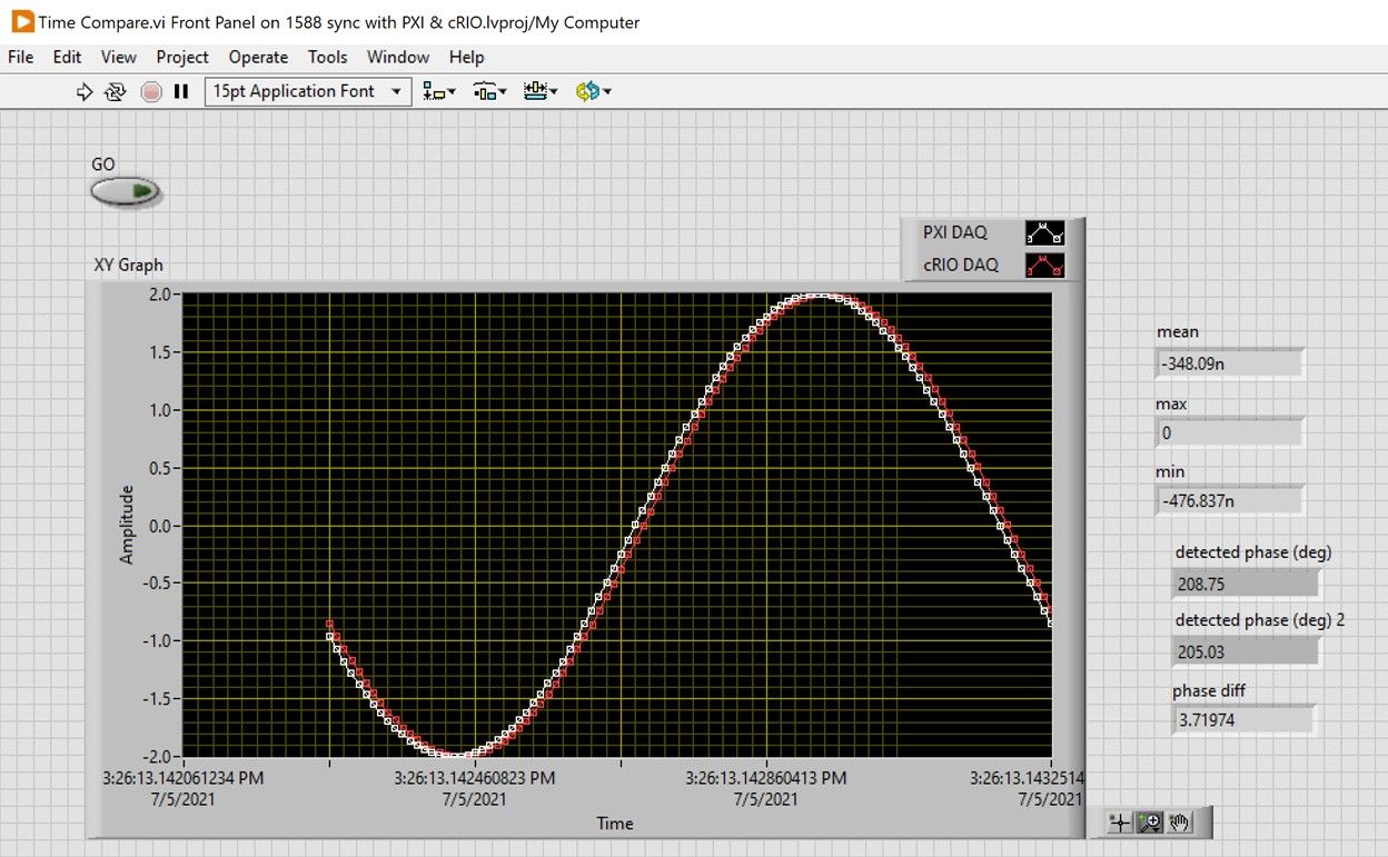

10. 5 seconds after running the program, the PXI-6683 PFI0 port will generate digital pulse as a start trigger to simultaneously trigger the AI acquisition of PXI DAQ and cRIO DAQ, and then record 100 data sampling points.
11. [Time compare.vi] is used for data comparison. The collected data is transmitted to the upper computer through network shared variables and presented in the same waveform graph as follows:

1. The synchronization performance between THE PXI system and the CRIO-904X system based on IEEE 1588 is stable at the sub-microsecond level, and the clock offset is within the error range of 100ns.
cRIO-903x series controller has been tested before. The same method can only be controlled in sub-millisecond level, and the clock offset fluctuates within 10us.
2. When running a DAQ task on both platforms, the time offset between sampling time points is less than 500ns, because the DAQ acquisition task is running at same time, so the jitter of clock synchronization accuracy increases.
3. Both platforms collect data from the same signal source, so theoretically the two waveforms should completely coincide. However, due to trigger time offset, signal line length difference, sampling rate difference and other factors, waveform may be different in phase. The current phase difference is 3.7°, which translates into a time is about 10us.1. The synchronization performance between THE PXI system and the CRIO-904X system based on IEEE 1588 is stable at the sub-microsecond level, and the clock offset is within the error range of 100ns.
