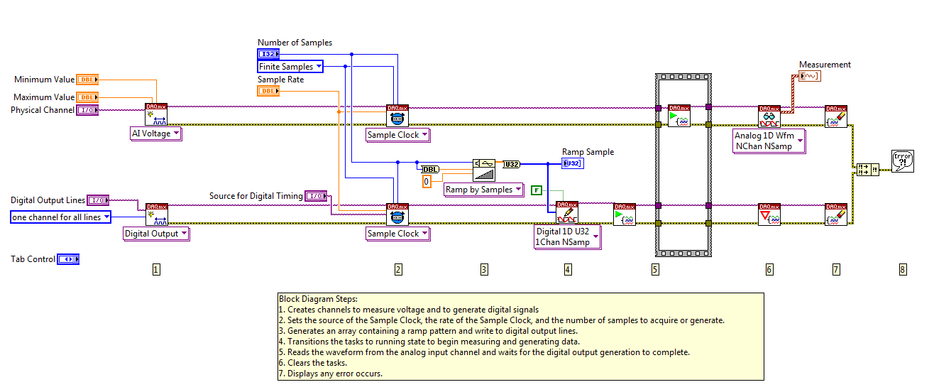

This example uses DAQmx to synchronize finite generation and acquisition of Correlated Digital Output with an Analog Input Task respectively.
Descriptions:
Correlated I/O enables synchronization of on board digital I/O lines to a clock reference. Digital and Analog samples can be synchronized in time by sharing the AI clock as the source of your digital I/O clock. You may also use the Counter Output pulse as the Source of Digital Timing. Hence, set the Source for Digital Timing as ai/SampleClock.This  example will work on any device that uses DAQmx and supports Correlated  Digital I/O. To perform Correlated Digital I/O on 9172 Chassis,  you need a Correlated Module in slot 1-4 of the chassis.

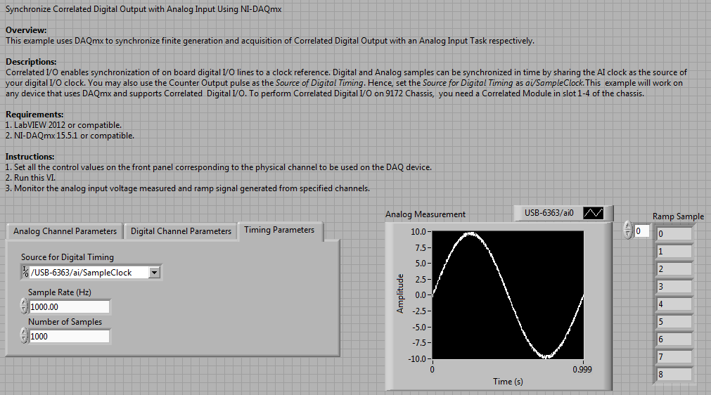

  1. Set all the control values on the front panel corresponding to the physical channel to be used on the DAQ device.
  2. Run this VI.
  3. Monitor the analog input voltage measured and ramp signal generated from specified channels.
Block Diagram Steps:
  1. Creates channels to measure voltage and to generate digital signals
  2. Sets the source of the Sample Clock, the rate of the Sample Clock, and the number of samples to acquire or generate.
  3. Generates an array containing a ramp pattern and write to digital output lines.
  4. Transitions the tasks to running state to begin measuring and generating data.
  5. Reads the waveform from the analog input channel and waits for the digital output generation to complete.
  6. Clears the tasks.
  7. Displays any error occurs.
