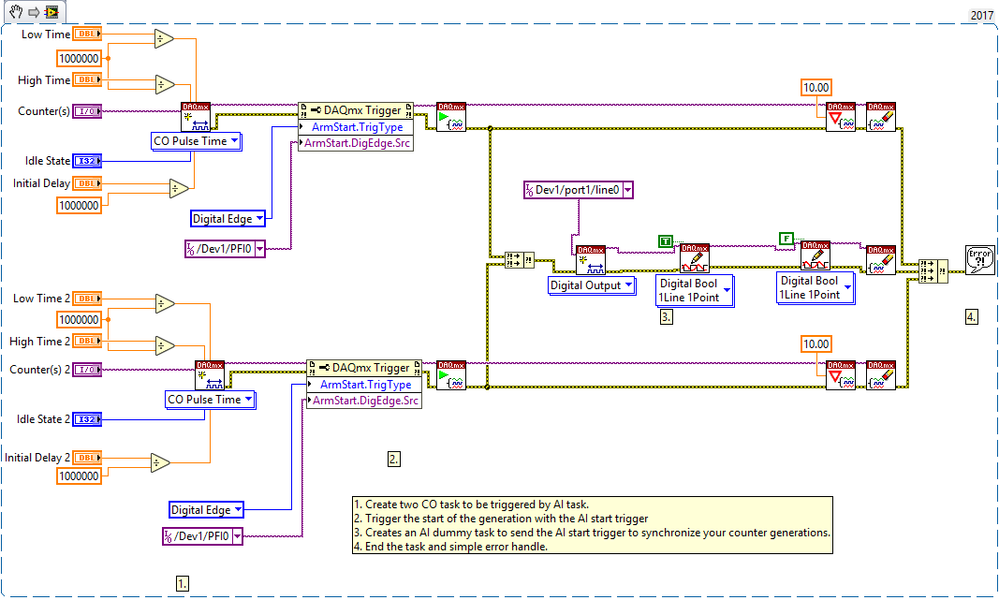

This example uses an AI start trigger generated by a dummy AI task to synchronize two counter output tasks.
Description
This program works by using the AI Start Trigger to start the counter output tasks.  The AI dummy task sends an AI start trigger when the AI task starts, thus starting the counter. This trigger could be used to start other DAQ task.

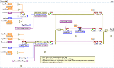

Thank you for this great example. I got it to work on an NI-6363.  However, I would like to use a dummy digital task. Is that possible? This is the change I made for digital but it times out at the wait until done. Sync Two Counters_DI.png

Got it!
