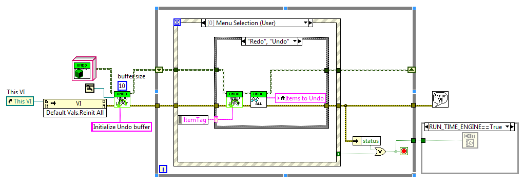

Folder 1UndoUsingLVmenu:
Has the "Application Item" version of the Undo, Redo menu options. If you execute this VI in the development environment it works fine, but when it is built into a stand alone application (exe) the Edit menu is grayed out.
Folder 2UndoUsingUserMenu:
The main VI here is called "Undo-usingUserMenu.vi" and it calls "UndoFGV.vi" which is a Functional Global Variable (a.k.a. Action Engine) that implements the Undo/Redo functionality. This VI works well both in the development mode and as an exe. It uses the customized "UndoMenu-UserMenu.rtm" menu.

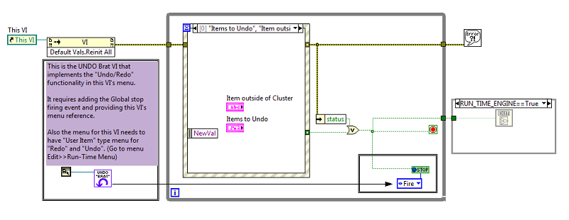

Folder 4UndoBratVI
An example of a "Brat VI" solution. UndoBrat.vi can be placed in the block diagram of any VI that has a run time menu with "User Item" type menu tags for "Undo" and "Redo" and it would implement this functionality. The only other thing that needs to be added is firing the global stop event.
This VI uses "Tool-GetParent.vi" and "VIG-GlobalStop.vi" presented by Norm Kirchner in his SMoReS presentation at NI Week 2010: https://forums.ni.com/t5/Past-NIWeek-Sessions/LabVIEW-Design-Patterns-and-SMoReS/ta-p/3510671
The UndoBrat.vi will only undo/redo controls, indicators won't be modified by it. Also, booleans with latch mechanical action will be ignored, because LabVIEW can not read nor write its value using property nodes.
