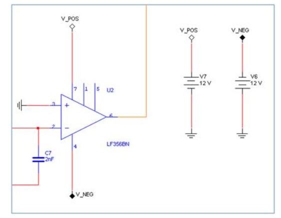

- The virtual connection has been created between the two nodes (Figure 8).
Figure 5 - Competed Connection

- The virtual connection between the two nodes will be created (Figure 9)
Figure 6 - Global Connectors

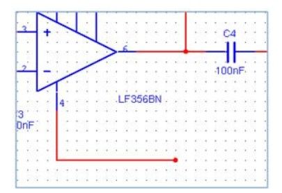

- Notice that the negative voltage rail on the operational amplifier is not connected to a power source (Figure 10).
Figure 7 - Unconnected Power Supply

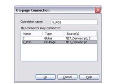

- Connect the On-Page Connector to the wire. Notice that the dialog box lists the V_NEG connector, but not the V_POS connector (Figure 11). This is because V_NEG is a global connector and it exists throughout the design (including through hierarchy).
Figure 8 - Making a Global Connection
