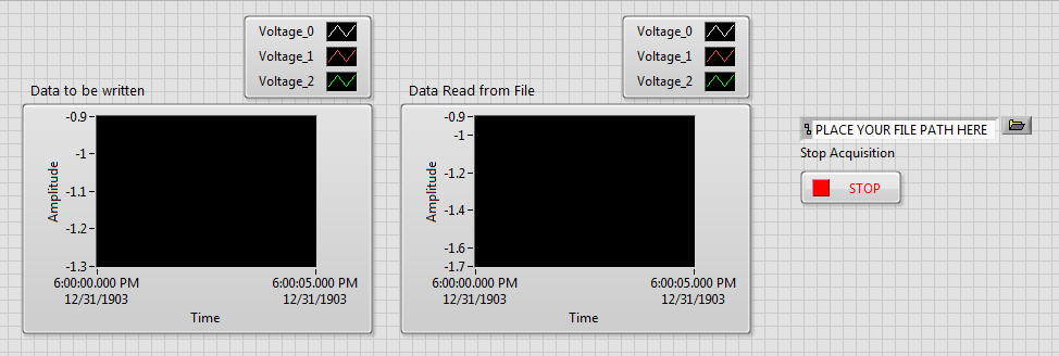

This example shows how to write multiple waveforms from a single acquisition to file using the Write Waveforms to File VI and then reading that data back in.
Description
When you write a waveform directly to file from a DAQ Assistant and then read it back in you only get the last "chunk" of data that was pulled from the devices buffer. This code provides a work around for reading waveforms back from a file by writing all of your data out as a single "chunk" so that it is read back in its entirety.

  1. Specify a file path on the Front Panel
  2. Configure the DAQ Assistant to use your hardware. This example takes readings on three seperate channels.
