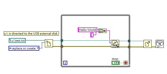

Overview
This VI writes a basic concatanated string to a text file on an external USB drive connected to the USB port of an NI cRIO controller, however, should be applicable to the majority (if not all) NI RTOS controllers
Description
This VIS take a basic "Hello World" string, concatanates it with a Comma, and then writes it to the USB drive connected externally. The address is simply u:\ and then the name of the file.
IMPORTANT - The USB stick has been formatted to FAT32
Requirements
Software
LabVIEW 2013 (or compatible), LabVIEW Real-Time Module
Hardware
I used a cRIO 9025, however, any RTOS controller should work
USB Drive Formatted to FAT32
  1. Place VI under RT component of project
  2. Set fil name in file path
  3. Run
