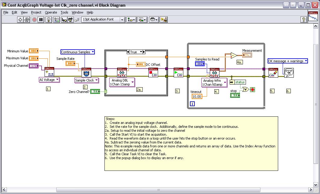

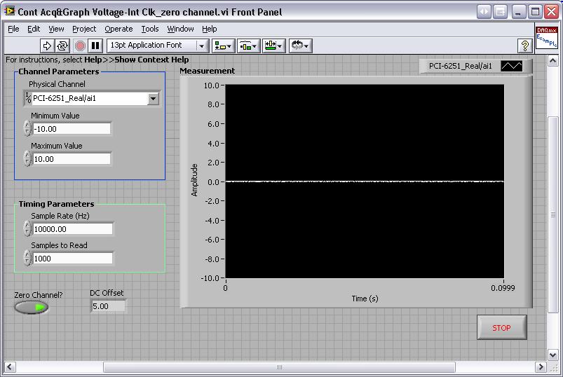

This example shows how to zero an analog input.
Description
If you have a DC offset that you want to zero out at the beginning of your program, change the sampling rate while acquiring data.

  1. Configure the parameter for the right channel and device
  2. Connect your hardware appropriately
  3. Run the VI
