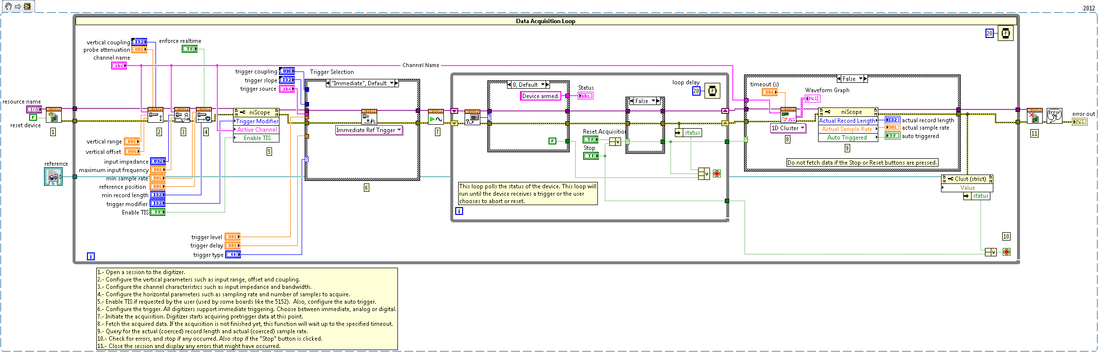

This VI is an expansion of the example niScope EX Configured Acquisition.vi which enables resetting the acquisition before the the device is triggered.
Description
This VI takes the standard niScope EX Configured Acquisition VI (LabVIEW shipping example) and adds functionality to be able to poll the status of the device. This allows the user to reset the acquisition after the device is armed but not yet triggered or even to abort the program while the device is waiting for a trigger to occur. To poll the device, the niScope Acquisition Status VI is used, which indicates whether the device is armed (waiting for trigger) or the acquisition is complete.

VI Block Diagram
