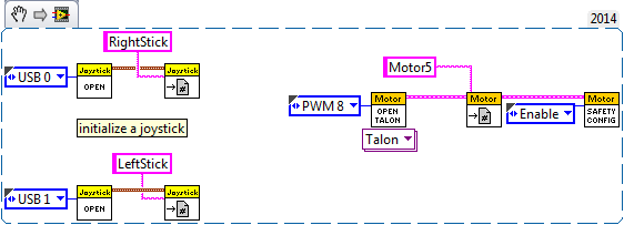

Thanks for posting your code, it helped in troubleshooting.  From the code you posted, it looks like you are trying to get the motor connected to PWM 5 to move in one direction when button 0 on LeftStick is pressed and to move in the other direction when button 1 on RightStick is pressed.
You will need this code in the "Begin" VI.  This code sets up both joysticks and the motor.  I used PWM 8, but you would use PWM 5.

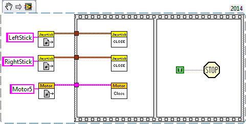

Finally, to close everything properly, use the following code in the "Finish" VI.  This will close everything out well.

Since we implemented the motor control in the Teleop.vi, remove any subVI that has "MOTOR" at the top and is that orangish color in the Scheduling loop.
Also, we're opening the joysticks twice: once in the Begin.vi and once in the Scheduling Loop.  I would get rid of the "Joystick Open.vi"s outside the loop and keep the ones in Begin.vi.  then, you could call the joysticks by reference just like you currently do in the Teleop.vi.
Finally, if you follow the model we've set up by opening references in the Begin.vi, using those references in the Teleop.vi, and closing everything in the Finish.vi, there shouldn't be a problem moving the drive control to Teleop.vi.
