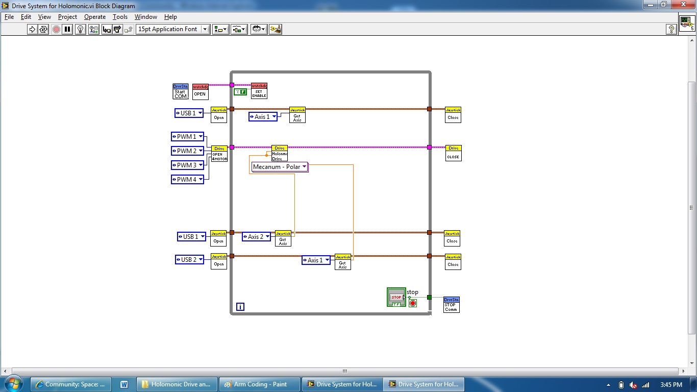

          FIGURE 2- Holomonic Drive System Coding
2. How should the FIGURE 2 coding be set up to make the robot move directly left and right, forward and backward, and cause the robot to rotate while using omni wheels?
Since you have three different motions, you'll need to have three different joystick axises. Most teams either use 2 different joysticks, or buy a joystick that has 3 or more axises built in.

About the Drive System coding, is the code in the picture below suitable for 2 joysticks (one for forward/backward and left/right and a second joystick for rotation?
And if i wanted set up a joystick that has a 3rd axis (Z), would I add another "get axis" on the same joystick as the others are on and select Axis 3 and connect to rotation?

I updated it but my Omni Drive System code still NEEDS HELP.
It uses 4 omni wheels on each side of the robot, making it multidirectional.  The setup and code are in pictures below, and the labview coding file is attached.
How do I make this work?
thanks,
Davis Catherman
Your code looks good if you had a drive train that matches what the holonomic drive VI expects. The description of holonomic drive says it is for mecanum drive or omni wheels mounted at 45 degree angles to the frame. Your drive arrangement doesn't match either of those, so the holonomic motor drive will not work. With the omniwheels mounted at 45 degrees, to go forward you set all 4 motors forward. With your arrangement, you set 2 motors forward and 2 motors off. You will need to derive an algorithm specific to your drive train. I would recommend using separate motor vis for each motor, rather then trying to use robot drive.

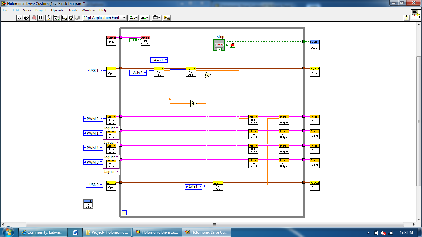

Do you mean like this?
Or each motor to be on a completely different VI?
The new code is also attached.

In that last code screenshot you posted, why are you setting individual motor values based on the first joystick, then immediately setting all motor values to one axis from the second joystick?  Without that, it might work.
It would be a good idea to put a wait of some sort inside your while loop to allow other processing to occur.  Without one, your loop runs as fast as possible, preventing other functions (such as communication with the driver station) from responding.

@sciencewhiz
Yea, i understand that system now, I noticed that my teams robot moves diagonally with that coding (makes sense)
Also, the last peice of coding I provided, Is that what you meant?
@nathand
I have it set to the first joystick so that when the first joystick is used, it will moved directly with the robot (forward, backward, left, right).
Then it is set to the second joystick so that when that is used, it will turn the robot (rotate)
(thats the thoery at least, doesnt seem to work)
And yea, I need to add a loop delay.

43803490 wrote:
@nathand
Won't work.  You set the values from the first joystick, then immediately overwrite them with the value coming from the second joystick, so the first joystick does nothing.  I'm not sure I understand exactly what you're trying to achieve, but you might try taking the output from the second joystick and putting it into "In Range and Coerce."  If I remember correctly the joystick axis value is something like -32000 to +32000, so try setting the limits to +10 to -10.  If the axis is in that range, then it's basically 0 and you should use the values from the first joystick.  If it's outside that range, then someone/something is pushing on the second joystick, and you want to use that value instead.  You can put a case structure around the Set Motor commands, or use a Select to switch between values going to it.
However, I'm not really sure why you'd want to do that, since pushing the first joystick toward one of the corners should have the same effect of driving all four motors at once.
