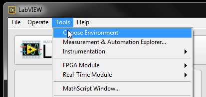

I had LabView 2014 on my PC before kickoff. Once kickoff happened, I loaded the FRC Utilities. When I bring up LabVew 2014 it still brings up the default Non-FRC Labview project launcher. How do I get to the FRC project launcher to help with setting up default robot project?

Joe,
I too have LabVIEW installed and had to do the following.
  • Install the LV FRC2015 (Even if you have LV already installed)
  • Install the updates
  • If the Getting started window shows the standard LV screen
  • From the Dropdown menu select Tools->Choose Environment
  • Select the "LabVIEW for FRC" item in the list
  • Click on Apply to change to the FRC environment.
  • Revers the process if you want to go back to the standard LV environment.

Thanks. I did wound up uninstalling LV 2014 and reinstalling the stuff downloaded from the FRC downloads page. then install the utilities and it seems to work.
