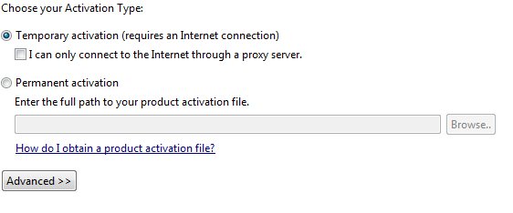

- I've been choosing Temporary activation since I have no idea where to get the activation file.

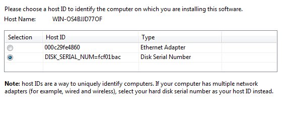

windriveractivation2.jpgI've tried both hostid's

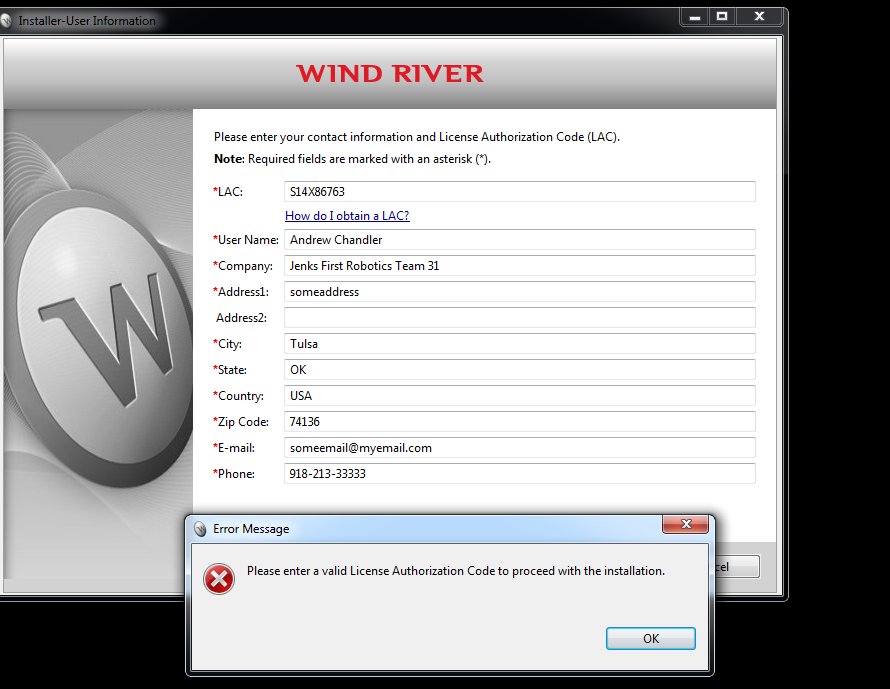

Now I changed a couple details on this next scrrenshot but this is where it goes wrong

That is the wrong disk. You want the National Instruments DVD, not the Windriver DVD. See http://wpilib.screenstepslive.com/s/3120/m/8559/l/89700-installing-the-2013-frc-driver-station-for-s... for instructions.
