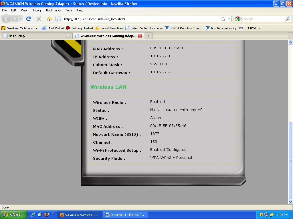

It would help if you posted screenshots of the configuration of the router and the bridge so that other people can review the configuration.

At the competitions, you had to enable encryption on the bridge to work on the competition field. If you did not remove it, it will not work with your router, which does not have encryption enabled. The fact that you say you haven't tried it since April makes me think that is the problem.
Like I said earlier, if you post screenshots of the configurations of the bridge and router, we might be able to really help you, instead of just guess.

The encryption seems to be the problem that I was looking into.I actually missed that part while checking for my settings  and my settings looked like this !
That solves my problem !.I really appreciate your timely help !
