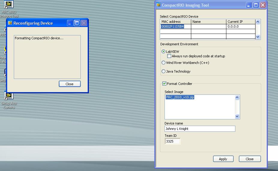

     We are still having that problem. This time, when it asks us to format this it says "Formatting CompactRIO Device..." but it never leaves that message. Here is the picture.

Formatting the cRIO takes a few minutes. Are you seeing that this message stays up for longer 5 mintues?

     Yes in fact before the update, it would image fine then we updated, now it dosen't work. In fact, we left it running for about a 15 minute time span and still did not format.

You picture shows image v10. The latest is v19. Either you didn't install the right update, or it didn't install correctly.
