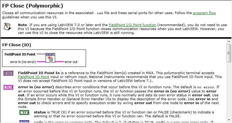

Hi Tim L.,
I'm surprised that you did not see the FP Close function in LabVIEW.  I still have it in LabVIEW 2011:
Is there something else more specific that you meant by "doesn't work?"

The vi is there but during deployment is says something like --Cant find funcuntion vI_........---
It appears that it hasn't been included in the fieldpoint library (the one installed via MAX)
