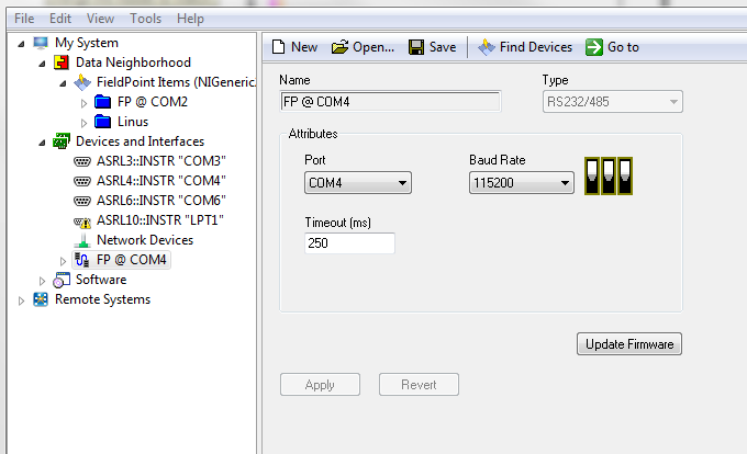

As I asked originally, I am trying to figure out if it's possible to build a drop down control onto the front panel of the vi to select the COM that the cFP devices are connected to.
My latest post was an update based on becoming a bit more familiar with the cFP and associated .iak file.  Considering that the COM port is specified in the .iak file, how can you make this a controlled item?  The issue I foresee with deploying this vi is that the cFP device may or may not be plugged into the COM port specified in the iak file.  Although, after looking at the format of the "FieldPoint IO Point In", I see that it specifies the "comm resource name".  If the device is named and the correct comm resource name is listed in the FieldPoint IO Point In, is the physical COM port irrelevant?  I don't imagine it is, but just asking the question.

Here is a screenshot from MAX for the "Comm Resource Configuration" for a serial cFP device.
