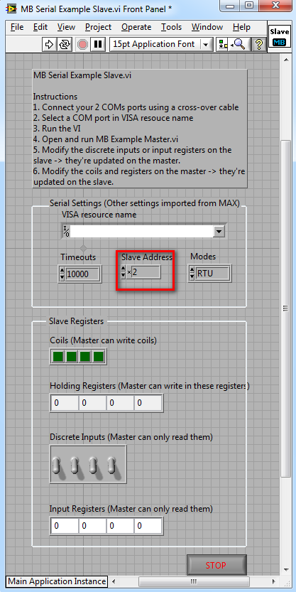

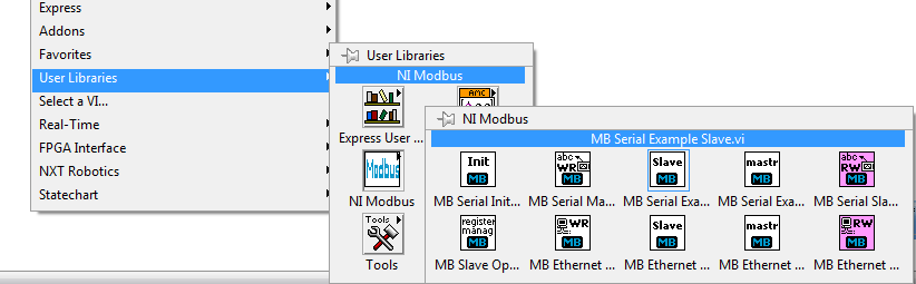

If you have the full version of the Modbus Library, and you have moved the lib files into your vi.lib folder in your LabVIEW directory, you should have the VIs I mentioned. To access the MB Serial Example Slave vi and change your slave address, right click on your block diagram to open the functions pallette, and navigate as follows:
Once you have the MB Serial Example Slave vi on your block diagram, double click on it and you will see its front panel. The slave address of the device may be set here:
MB Serial Example Slave vi.png:
Hope this helps.

Hi ~kgarrett,
Thanks but I don't think you understand what I am looking for. In the example you cite, the 'Slave Address' field is the address of the RTU slave VI. This example allows a VI to act as or simulate an RTU slave. This does not apply to my question. I have an existing hardware RTU slave, a cFP-180x with an address of 1. How do I change the RTU address burned inside the cFP-180x?
For example: Suppose that you had a slave cFP-180x with an RTU address of 1 and you would like to change its address to 123, how would you burn the new address of 123 into the cFP-180x? I don't think there is any functionality in the MODBUS library to do this. So how is it done?
Of course, once you burned the new RTU address into the cFP-180x you could use the Master RTU functionality in the MODBUS library to communicate with the cFP-180x. In this case, the Master RTU example would be used (the other RTU example) and the 'Slave Address' field would be set to 123 into order to communicate with the cFP-180x slave we just re-programmed to address 123.
So, How do I change the RTU slave address in a cFP-180x?
