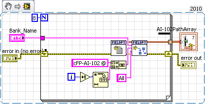

Below is a snippet of some code which behaves differently according to what the bank name is in MAX (it builds a path array to all of my AI-102 modules):

It seems that when I compile and deploy this app with the bank name set to "Bank0" in the project explorer, the path array builder VI works fine. But when I change the bank name in MAX to something like "Bank9," I get 32812 errors (specified tag name was not found). So it seems I can look up a bank name as changed in max using "Target Information" but the FP Create Tag does not work if the name fed to it is something other than what was originally deployed with the application.
(7,609 Views)
I found a workaround for this problem finally but I don't think it's supposed to be working this way as it's not very intuitive. If I take my path builder and hard code the bank name it is using to whatever I had in the project I used to create the build, I can change the DNS name as I please in MAX and the path still works well. So, the fact that the name of the fieldpoint module in the project is worked into
the path has nothing to do with the name created in MAX even though the name in the project defaults to whatever you have in max when you create the project! Is that working as designed or should I report this as a bug?
Here's a snippet of the workaround:
(7,605 Views)

I am connected to the cFP-2200 over a LAN. I can have several of these at a given site which is why the name needs to be flexible. I also use the name in some VIs for various purposes, such as configuring dynamic TCP listeners on a server application.
When I say "DNS name," I'm referring to the "RT Get Target Information.VI" under the RT toolkit's output cluster and specifically, the element "IP Settings.DNS Name." This is also the name I would set for the target in max and when I do this, the output of "IP Settings.DNS Name" changes with it. Also, when I click "find devices" on the cFP in max, the default comm resource name for the device in the iak file is whatever I had set for the "name" at the time.
The "FP Create Tag.VI" which I am using to create paths to the inputs of the target has an input called "comm resource name." Since this was set to the same thing as the "name" in max, my expectation was that changing the name for a device in max would also change its comm resource name. However, my example above shows my expectation does not match what is actually happening. While the DNS Name is tied to the name set in max, the "comm resource name" is not even though during the initial creation of the iak file in MAX, they are the same.
To make a long story short, I am able to get my software to work by making sure that the comm_resource_name is hard coded to the value originally set in the project which created the build. This solution is adaquate but not optimal because I would rather be looking this up dynamically for the sake of maintainability. If the comm_resource name and DNS Name are separate entities, that is fine. There just needs to be a way to look both up dynamically if they are separate.
I guess this has become more of a suggestion than a problem I'm reporting... unless of course the behavior I'm describing is not what NI intended, in which case it's a bug.
(7,592 Views)
