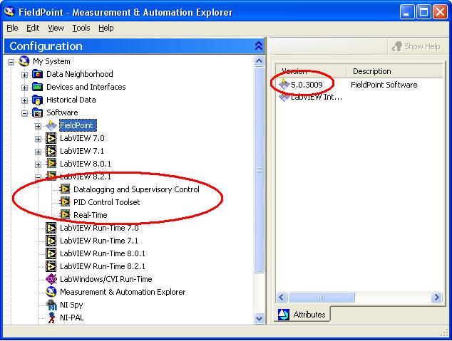

Hi YASEN,
Let me make sure that I am understanding your situation correctly, you receive a timeout error when you are attempting to add/or remove software.  Is this correct?
If I have misunderstood, can you please clarify and include a screen shot of the error you are receiving?
Also, can you please give me a screen shot of all the software you have installed on your host?   Make sure to highlight FieldPoint so I can see what version of the FieldPoint driver you have installed.  Also expand the version of LabVIEW you are using.  I'd like a screen shot similar to the one shown below.
If you are able to see the add/or remove software list before the time out, please include a screen shot of that as well.
