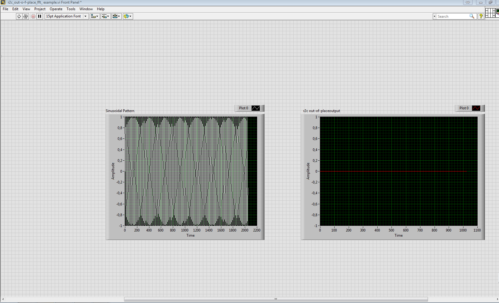

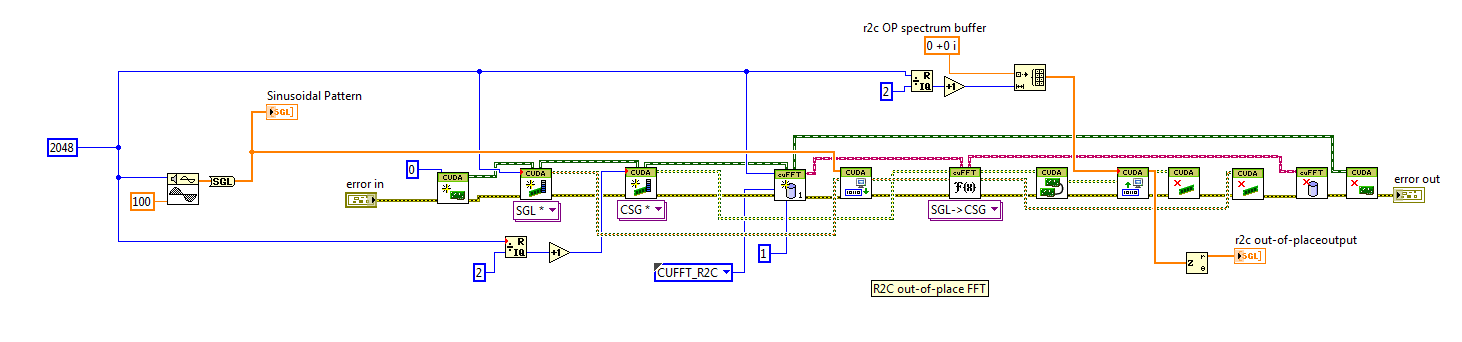

Hi everyone,
I need also an 1D Fourier Transformation like Xsword, so I tried his out of place example to understand how I can adjust his VI for my application. But there is one problem. I don't get any output. I'm working with Labview 2015 on a PC with Win7. I also tested already if the CUDA Toolkit is installed correctly using example code provided by nVidia. With this examples everything worekd fine. At the moment I am not able to figure out why the VI isn't working properly. Maybe some one could help me with this issue? I attached a screenshot of my output with this Xswords example and a screenshot of the output I obtain, if I using the 2D FFT example provided by NI.
Maybe someone of you could help me with this issue?
Thanks in advance.
Simon
EDIT: I solved the problem. I used version 7.5 of the CUDA Toolkit, but the GPU Analysis Toolkit can not work with this, so I installed version 4.1 and now everything is working.
