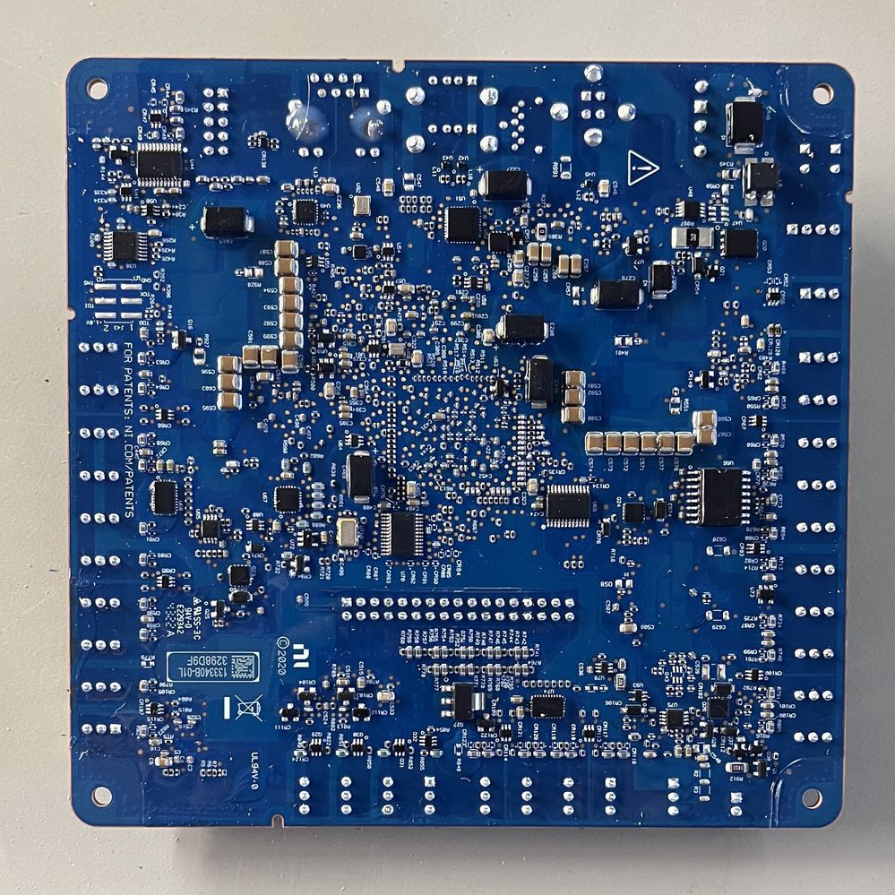

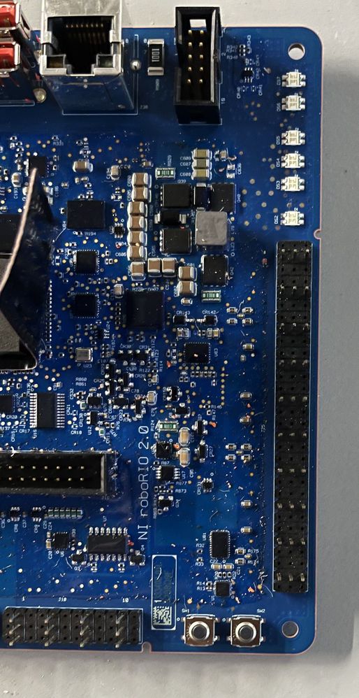

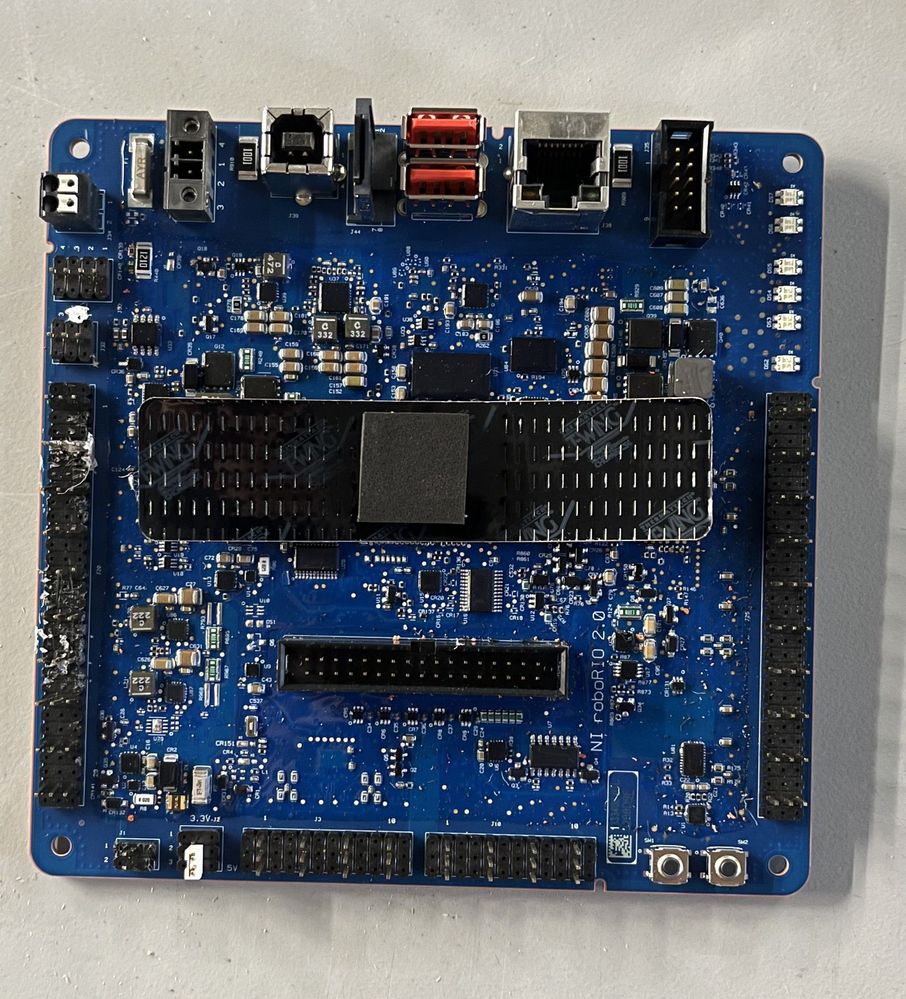

Hi Diego,
The power light is red and all the other lights accept for RSL are off because we don't have anything plugged into it.
It does get abnormally hot.
I took it apart and cleaned it with compressed air.
Didn't see anything out of the ordinary, no metal shavings.
Put it back together, plugged it in and the same lights came up.
And the Live(+) still reads 0v.
Let me know,
Thanks.
