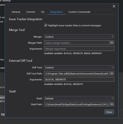

Its a nice git Client. But I dont get the Merge Tool and the external Diff Tool to open LVCompare.
So this doasnt work:
Help is appreciated!

Without knowing Fork I'm wondering wheter the comma in your argument list is correct. I'd try without.

Here's a screenshot of how our good friend benjamin-hinrichs configured Git Fork:

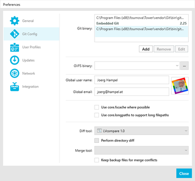

 And if you, like me, still prefer Git Tower (or other clients that do not offer native support for absolute paths in arguments) over Git Fork, you can look into this link to make it work:
https://community.atlassian.com/t5/Sourcetree-questions/SourceTree-external-diff-path-issue-on-Windo...

Here´s what works for me:
For the lazy:
Diff Tool Path:
C:\Program Files (x86)\National Instruments\Shared\LabVIEW Compare\LVCompare.exe
Arguments:
"$LOCAL" "$REMOTE" -nobdcosm -nobdpos
