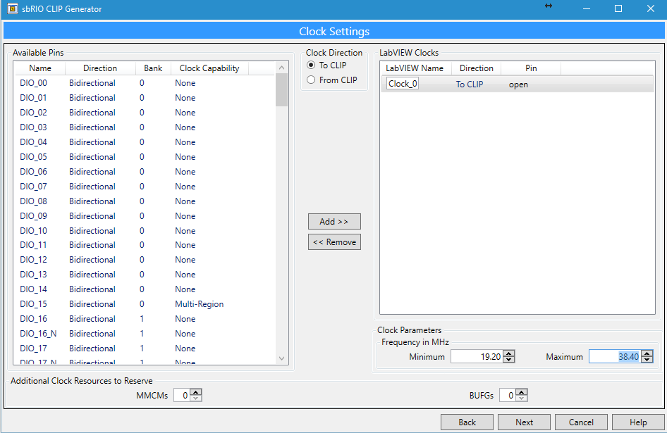

2, I have generating clock from FPGA ( to CLIP), configured like below, it works, but I didn't find any option to disable the clock or configure the speed of that clock on the fly, do I missing something here? or it been designed to be like that?

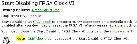

1. When you are importing a clock through the CLIP into LabVIEW, you cannot use the Start Enabling FPGA Clock or Start Disabling FPGA Clock. This is stated in the LabVIEW Help for those VIs.
The functionality is not built into the sbRIO CLIP Generator to allow for a control line to enable or disable and imported clock.

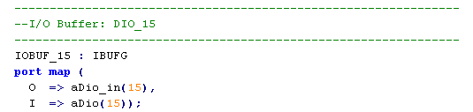

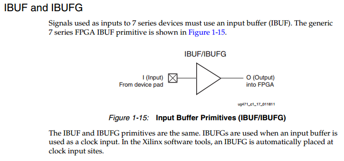

The CLIP Generator using an IBUFG primitive, which you can see in the VHDL file generated from the CLIP Generator. An IBUF does not have an enable signal, it is just a global clock buffer to take the clock signal from the pin to the global clock network on the FPGA. An IBUFG is in the I/O Block near the pin you are importing the clock from. An IBUF is described further in the 7 Series FPGAs SelectIO Resources User Guide.

A neat note here is that on the LabVIEW Interface page of the CLIP Generator, if you clock on the Data Type you wish, but do not click on any of the pins, it will create the VHDL and XML necessary for LabVIEW to see that node, and it will be available in the CLIP for you to modify. This could be useful for easilly creating a LabVIEW control signal to use with the BUFGCE.

2. There is not an option in the sbRIO CLIP Generator to change the clock frequency of an exported clock on the fly. This uses an MMCM to generate a frequency off of the 40 MHz base clock, I believe. I was able to find some information about Dynamic Reconfiguration using and MMCM or PLL. You could potentially instantiate one of those into your CLIP, but would likely require intimate knowledge of both VHDL and the clocking resources available on the 7 Series fabric. I have not tried this, but here is the link.
Otherwise, you can create a derived clock that is much faster than 40 MHz in the LabVIEW Project and write some SCTL code to divide that down, but it will be in multiples of the 40 MHz base clock. The exported clock functionality is really meant to provide a fixed frequency clock to drive other peripherals.
