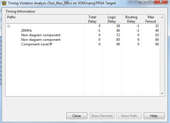

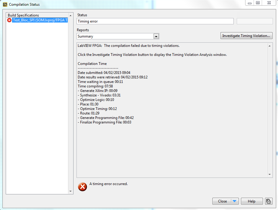

We arrive to my issue, now I try to use my CLIP in a small VI (just to check). The compilation "failed" due to : Timing violation.timing_violation.PNG
Investigate Timing Violation...:
When I try to modify my VI by removing some I/O, sometimes I succeed to compile but the issue doesn't depend on a particular I/O. For me, it's just the number of I/O present on my VI which creates the problem. I need all my IO to have my SPI communication...
I tried to acces my I/O one by one with a flat sequence, and with a timed loop. The problem is alaways present.
If you could advise me to resolve my issue of timing violation.

Can you share a screenshot of your CLIP in the project and the VI block diagram that fails to compile?

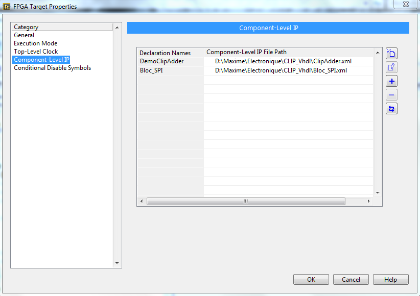

So firstly, I right-click on the fpga target-> Properties. I create a new file XML:

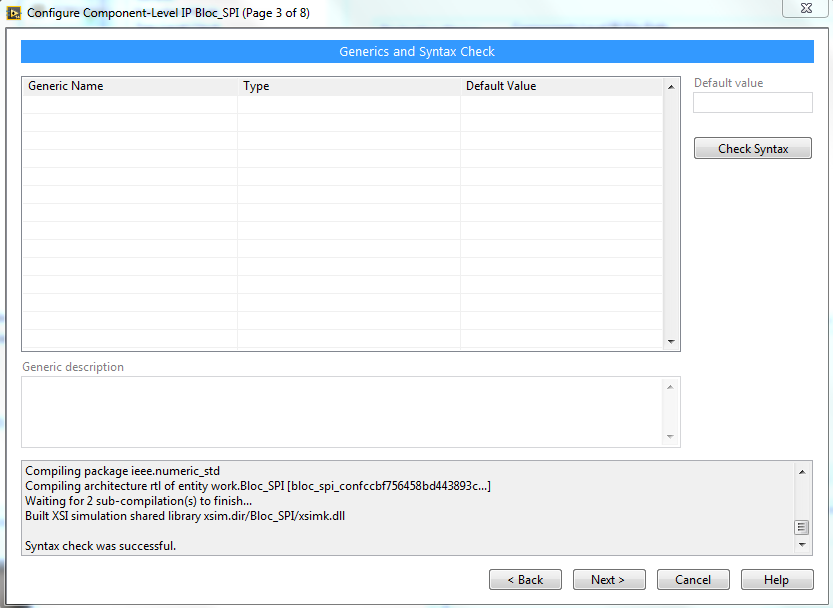

Secondly, I check my VHDL when I create the XML:

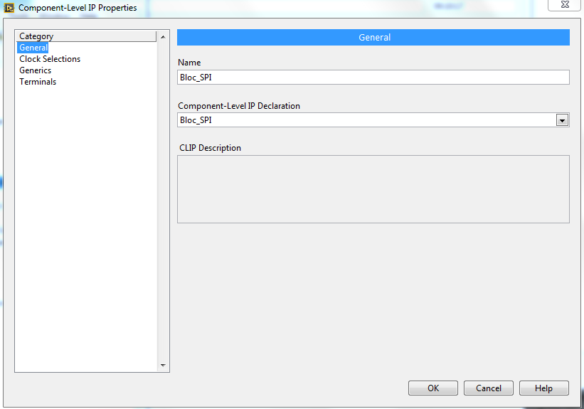

When my xml is generated, I add my CLIP:

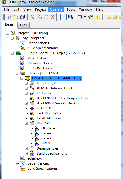

Finally, I have my CLIP (Bloc_SPI) in my project:

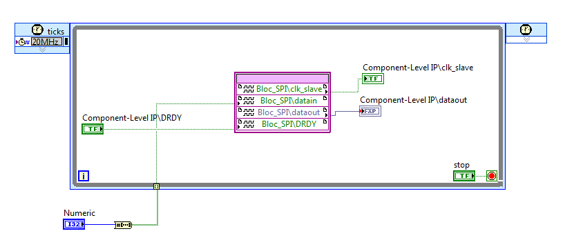

To finish, my VI:

The 9651 has a "socket" named "sbRIO-9651 Socket". For this test, you are using the "DevKit" Socketed CLIP in the 9651 Socket (which we provide). Then you added your own CLIP (unsocketed) and it looks like you named it "Bloc_SPI".  It looks like you read and write to the CLIP signals in a 20MHz SCTL (which I'm guessing is derived from the 40MHz clock).
