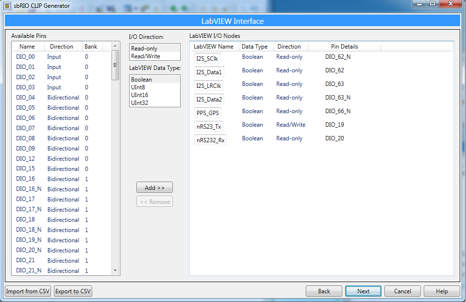

I wanted to post some details on how I've configured the CLIP for RS232, I wish to use the PMOD_1 inteface pins because they appear to be protected with transceivers so I don't hurt the SOM wiring 3.3 RS232 directly.
So I've configured Pins 19 and 20 for Rx and Tx. The unknown for me was it seems by default all NI SOM examples CLIP configure lines as 'bidirectional' in the pin configuration - even though a serial TX is an output only - but this seems to be configured on the "LabVIEW Interface" CLIP cfg page.
Message 7 of 27

On the "LabVIEW Interface" page, I assign Pins 19 as Tx "Read/Write" and Rx and "Read-only".
Message 8 of 27

QUESTION: Now when I update the revised CLIP to my SOM. I notice the SOM I/O list updates and shows three 'properties' for the Tx line as shown: Tx_in, Tx_out, Tx_enable.
Also when you drop the I/O calls on the diagram, the VI run>error reports you need the 'enable' function. Which I am guessing at the start of the VI and set to "TRUE".
