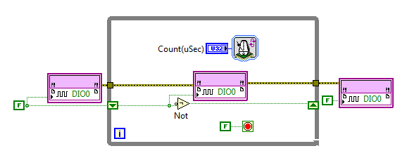

Output for a square wave can be done entirely in the FPGA, there is no need for DMA from the RT.
The frequency of the waveform can be controlled by the time delay of the FPGA loop. If you wanted to change the frequency of the waveform, then you would need to do this from the RT.
Here is what the FPGA code would look like, the "Count(uSec)" sets the timing of the wfm.
