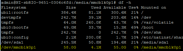

To circumvent this, I downloaded a third-party Windows-based tool from the web to format an SDXC (Panasonic SDXC Class 10, MLC) with FAT32. I then inserted into the SOM's Reference Carrier Board and was able to write and read from the card. I did the same process but with formatting the SDXC card with the ext3 filesystem that is supported on NI Linux Real-Time. I was also able recognize, read, and write to disk without issue. There are no hardware limitations that I am aware of that prevents using an SDXC card.
The reason we state that only SD and SDHC is supported is because our Real-Time development team has not tested and vetted that this works without issue. That being said, I was able to enumerate the drive and read/write to disk. I would recommend using the ext3 filesystem since it is journaled. Neither FAT32 or ext3 were designed for solid-state storage though we have used this fine in the past with USB drives on CompactRIO. For instance, the file table for FAT32 does not get wear-leveled. If you are creating a deleting a lot of files that causes changes to the file table, a vulnerability of FAT32 is that you will eventually "wear out" the file table.
Here is my successful enumeration of the SDXC card:

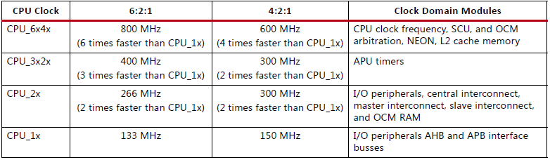

2. Does the ARM cores always running at maximum clock in RTOS? That means they are always consuming maximum power. While it is now allowed to shun down one core, it is possible to reduce CPU clock as specified by Xilinx? If yes, can we do it programmatically?

2. As you screenshotted, the TRM states that you can change the clock values. This is something that you can do by hitting the necessary registers during run-time or changing an environmental variable in U-Boot before boot but National Instruments does not support this. All testing and verification with both hardware and software have been done with the shipping settings and U-Boot configuration; therefore, we cannot recommend changing these settings.
