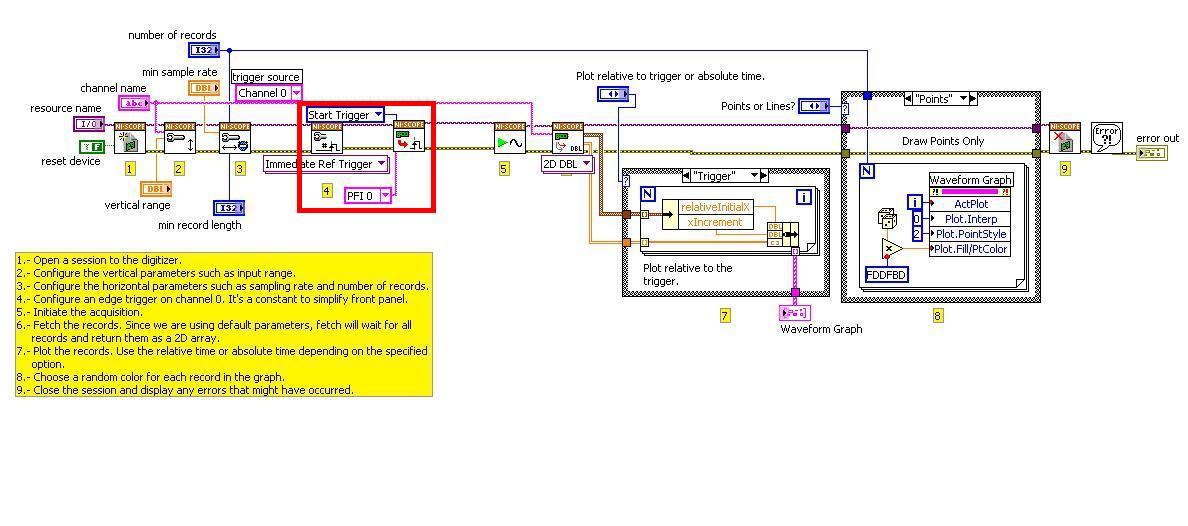

I am running Labview 8.2.1 on windows XP. I have a PCI 5122 high speed digitizer. I am trying to get a plus sent out on the PFI0 output of the device when the card is triggered. It seems that all I get is 4 volts from the device. I have set NiScope Export Signal wired in. This was an upgrade from Labview 7.1. I jncluded the block diagram of the signal generation.

I did test this with a different digitizer, you can see the code below, I've highlighted the relevant part in a red box.
The example modified was niScope Multi Record.VI . I added the niScope Export Signal and set the signal to be exported as Start Trigger and the destination to be PFI0.
This should get you going! You mentioned a 4v level, is this what you saw on the PFI line?
