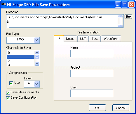

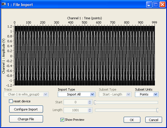

I've done a basic test to try and replicate what you are seeing. See the screenshots below. The behavior of the Scope Soft Front Panel seems normal on my end. If you are experiencing different behavior, can you explain what in detail? Screenshots would be very useful.
Data coming in: 2Vpp, 1MHz Sine wave
Saving Data Parameters
Loading Saved Data
