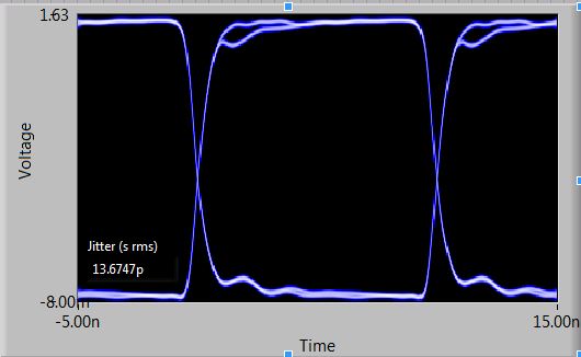

At the moment I do not have access to a chassis with a clock in function to drive the backplane, but I did take an AWG and generated a 10MHz reference and connected it to the PXIe-6556 clock in circuit (SMA connector).  I then configured the 6556 to use the clock in as the reference clock.  Next I generate at 50MHz signal and exported the sample clock.  I connected the sample clock to a oscilloscope and generated an eye diagram and calculated the jitter.  I've attached an image of the 50MHz clock output and there is not 2.5ns of jitter.
In your setup there is another piece to the clock path (the PXI chassis).  Inside the chassis there is a PLL that takes your 10MHz clock and generates a 100MHz clock.  The PXIe-6556 uses this 100MHz clock as the backplane reference.  Can you connect your reference directly to the PXIe-6556 and try to reproduce my results?
