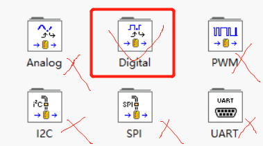

Hello, I'm happy to see your share, Now I have a Problem , Hope get some helps, It is:
I use LabVIEW 2020 Community Edition to control raspiberry pi4, I find use  demo to control digital output... konw the reason

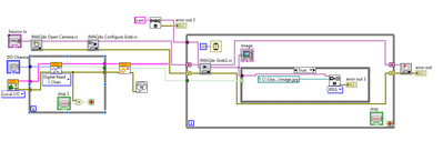

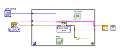

Hi;
can you help me please about pi connect with labview?
I try to coonect and I do it. You can see below my motion VI  under the LINX
  But I want to  trigger other vı with  signal that I can read from pi and this is my cam VI that I want to take foto with signal from motion VI. The cam is webcam, but I cant do this.

@rabia, the Vision toolkit is not something that will run on a Pi. You'll want to look into trying to get OpenCV running (perhaps look into QWaveOpenCV) or using other software such as mjpg-streamer or the pi's utilities directly though you'll need the ssh/chroot trick described at https://blog.digilentinc.com/using-the-chroot-ssh-trick/
The Pi is a pretty limited target when it comes to the larger LabVIEW development ecosystem.
