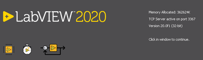

I am using LV2020 with the LINX toolkit installed from VIPM. I have a vi that will toggle a digital line which is connected to an LED. When I run the vi in development, everything works and my LED will blink. I can build the vi into a startup.rtexe and run it a startup without any problems. However, my program is not running because the LED does not blink. I have provided screenshots of the version of software I am using and what is installed on the pi.

I think I have figured it out. The version of labview I am using is 2020 but not SP1. I copied my project over to a computer with LV2020 SP1 and I was able to build and deploy my startup.rtexe from the project.
