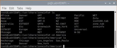

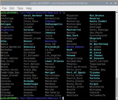

Choke
I think I understand what you are asking now.
What you are saying is that in Raspbian there is a timezone available for your local time America/Argentina/Buenos_Aires
But in the LabVIEW chroot this timezone does not exist.
So you are asking how do you get your local time in the LabVIEW chroot if the timezone file does not exist, correct?  The easiest way is probably to copy the timezone file that you want from Raspbian to the LabVIEW chroot.  The reason that the available timezones are different in each of these areas is probably due to the different versions of Linux running in each location.
