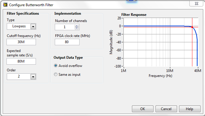

I had tried the FPGA Math and Analysis - Butterworth Filter, however i could not set the cutoff frequency  of 30MHz. As the expected sampling rate can only set to 40MHz - the FPGA clock rate. Am I setting the correct configuration?

Hi eton,
You are most likely not setting the correct configuration.  This VI requires that you set both the FPGA clock rate and the Expected sample rate to at least double the Cutoff frequency.  Please see the image below for a proper configuration.
This is a requirement in order to satisfy the Nyquist Theorem.  For more information, please see this document: http://www.ni.com/white-paper/2709/en#toc4 .
