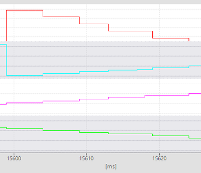

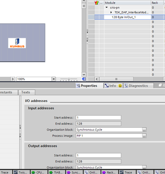

The reason why I want have this function is that, I need relize accurate Motor position control in the Isochronous Mode (at least 5ms, evenly), but after I do the test, the result is kind of frustrated, as there is no Isochrnous Mode can be checked for this Module in the TIAPortal as picture below, the normal one should like the picture on right, which Isochronous mode can be checked, but in the CRIO-PN one, there is no this check .

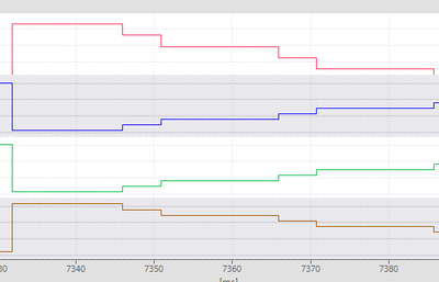

I want know if there is Isochronous Mode can be used for this CRIO-PN Module? After I run the test with no Isochronous mode checked, the result is not good, I send the command by Labview Real-time, 5ms, but the command received is varied from 5ms to 15ms, which as picture showed below left side, which cannot satisfy my demand for the accurate Motor Position Control. I think this CRIO-PN is used for the CompactRIO Real-time function, this result really frustates me, and I want reach the result as right side, which is all evenly 5ms.

Sorry, After I modify the GSDML file, I add the isochronous mode in the TIAPortal,
And I found out that the not equal time problem is due to my software bug
