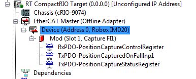

In project did our Master driver detect any modules if you right click your device and choose New>> Targets and Devices? Like in the Picture below:
If not that means it has indeed no mapping.
