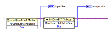

A query for the Raw Input Size or Output Size results always = 2

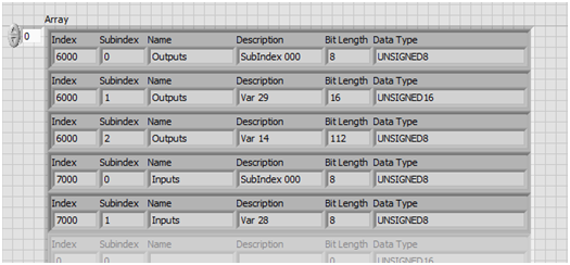

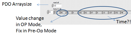

A manual adjustment of InputData arrays size (12) for Raw Data.ReadAll results in the following output:
The test data transmission from Beckhoff Master (Var 29) to LV RT Master is not working. The reverse data transfer (Var28) does not work either.

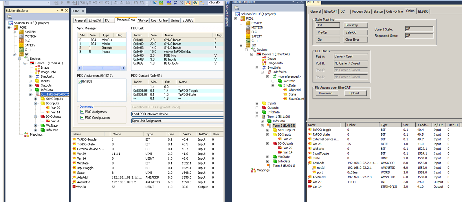

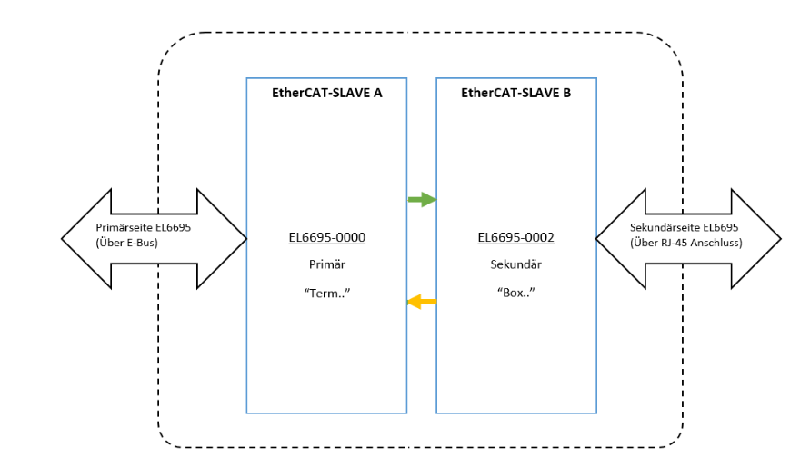

many thanks for your response. Normally the terminal should take over the role of the slave. As shown in the picture.

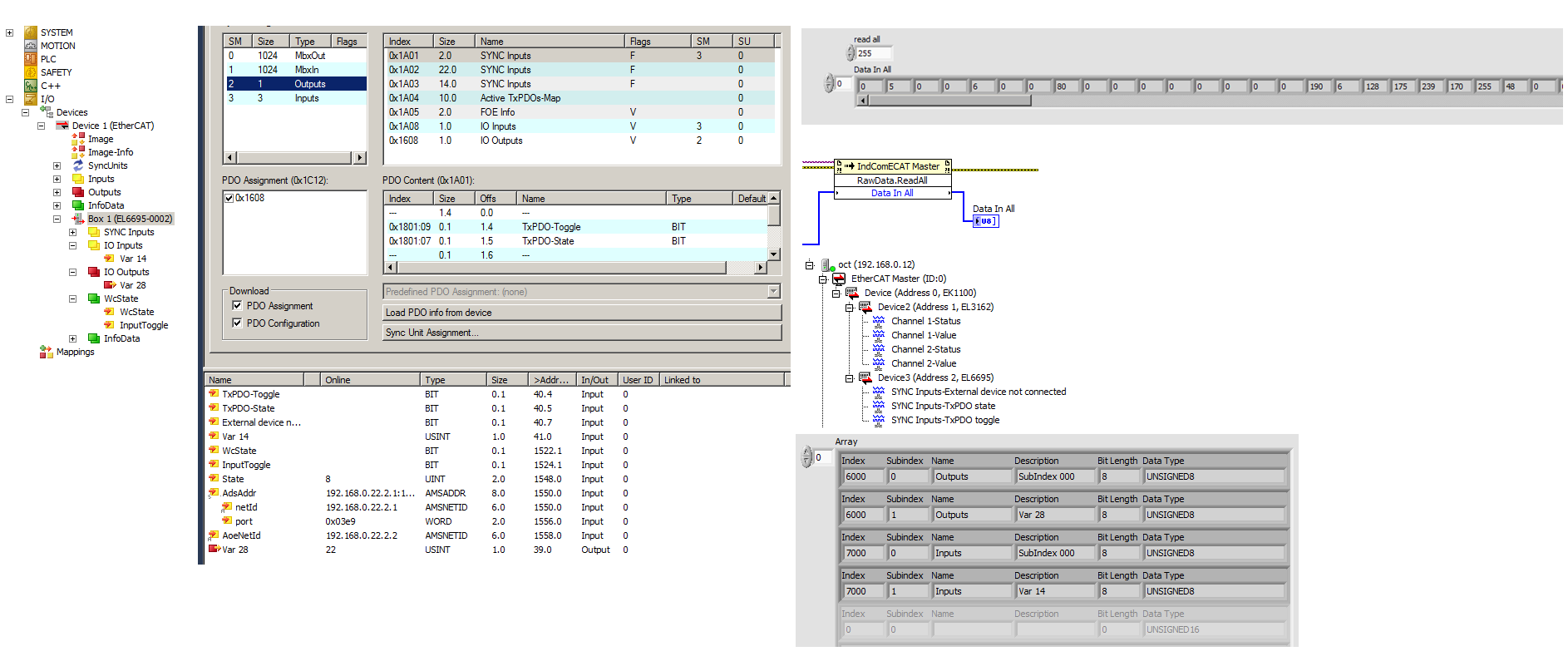

I again realized a simple configuration. You can see that the inputs and outputs are not be twisted.1.PNG

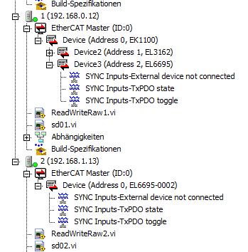

As you suggested, I have configured the network with a "normal slave" at the beginning. But the problem remains the same.2.PNG

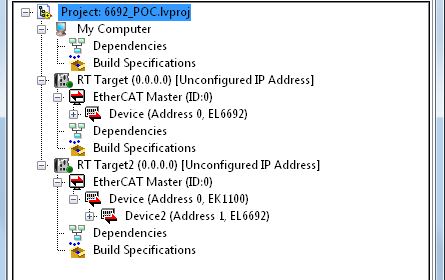

Actually we have got beckhoff EL6692 bridge solution to work previously. However EK1100 coupler was used to connect EtherCAT with the EtherCAT bridge terminal - EL6692. Here is the solution LabVIEW project screen shot:
EL6695 can also work I believe. They are similar bridge devices.
Above two masters are NI targets. You can also use EL6695 between one NI target and a Bechhoff Master.

Hi Jim,
Attached is the EL6692 proof-of-concept project.
However this was created by a US colleague 3 years ago.
I don't have Beckhoff devices on hand so I haven't tried it myself.
So I am not able to show you the result of the SDO query.
Please understand. Thanks!
