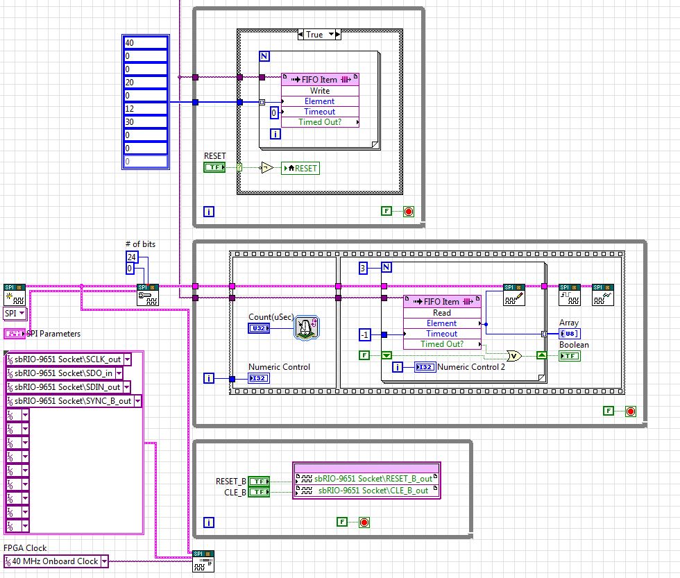

sorry I guess my last post was confusing becasue of the last image i inserted in there. I am copiling this VI. It is larger than one screen so i inserted it here in 2 pages. When I double click on the error it takes me into one of the sub VIs within the SPI API but the VI that I am compiling is the VI shown below

sorry, I guess my last post was a little confusing. When I double click one for the errors it takes me to the Sub VI that i pasted on my last post but the VI that I am trying to compile is this one (sorry, the VI is too large so I am pasting it as 2 pages):

I can't test this at the moment, but does the error go away if you assign signals to the CS1 through CS9 IO Name controls in the FPGA IO Names constant on your top-level VI?  Currently the IO name controls in that constant do not have selections.

ok guys, i finally got it allt working 🙂 thank you so much for your help.
Thanks again,
Farhad
