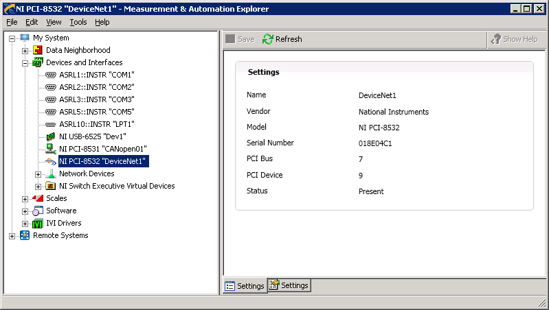

We use NI PCI-8532 was used as DeviceNet master to do functionality test with a slave (AC Drive).
But when open DeviceNet interface, it happen the error.
We can't find the solution and hope to find help from you.

First time to run sequece in TestStand, it can pass to run step 1) to open DeviceNet interface.
But once there is some error with these steps, and it will happen "Open DeviceNet Interface" error (error code=0xBFF62006) when run these steps again.
Then even use LabVIEW DeviceNet example to test, and it happen the same error except restart computer.
The DeviceNet example locates at "C:\Program Files\National Instruments\LabVIEW 2012\examples\NI-Industrial Communications for DeviceNet\Basic Examples\PXI & PCI\MixedCommunication.vi".
Some information more:
PC operate system: Windows XP SP3
LabVIEW version: 2012 SP1
TestStand version: 2012 SP1
PCI 8532 driver version: 2.3.0
Other installed PCI board: PCI 8531 CANOpen
