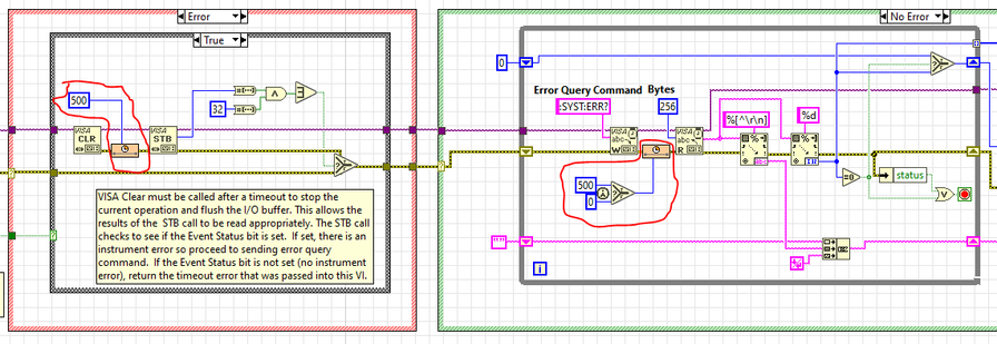

I have the EXACT same issue going on right now.  I tried your method in "Error Query.vi", but for some reason the problem seemed to appear in other locations where a write followed by a read would occur.  I'm using LabVIEW 2018 on a W10 x64 machine.
Something that I did that worked for me thus far is shown below, also in "Error Query.vi".  This is using LabVIEW 2018's "Stall Data.vim" function.  You could do it with a simple "wait" function too.
After some poking and prodding, I found that the first time this is called... in the "Initialize" routine where it's reset, etc... a delay of half a second seems to allow the DMM to have time to respond.  After the first time it's called... it seems to work even without a delay.  (Your mileage may vary).
Sometimes, I was seeing it freeze between "CLR" and "STB" as well, so I added a half second delay there too for good measure.  Haven't seen yet whether this makes a difference.

Good fix. I've noticed that the updated HP, then Agilent and now Keysight Technologies instruments seem to have much more verbose error messages.  Its caused problems in the init.vi of otherwise fully functional LabVIEW instrument drivers.  Not sure if that's part of the issue here.  If the call to :SYST:ERR? takes longer for the instrument to format its response, then a delay is a good fix.
Now to be safe I'd increasing that buffer size of the read bytes limit to more than 256, say 1024 or 2048.  Its really just a memory buffer maximum, so 10,000 isn't going to hurt performance and would be safe for large multi-line errors.  But no one ever makes those right? 😉
