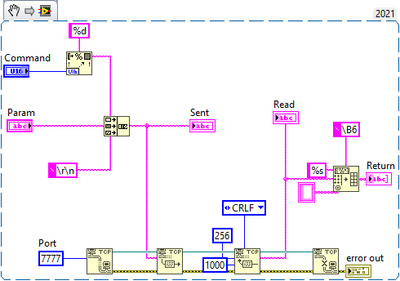

It's just to share my experience (that's why I don't open a new topic), as I also had to control a Weiss Climatic Chamber (using an Ethernet connection in my case).
I installed the Simpati software (evaluation only - V4.80), and after I configured the communication with the climatic chamber, I now only use a TCP/IP communication with the Simpati server to control the climatic chamber (you can find the protocol definition in the documentation installed with Simpati).
I can not garantee it, but it seems that there is no license needed for this part. I just prepared a script to launch SimCreate.exe, SimC3k.exe (depends on your model I suppose), then SimServ.exe -P7777 -start when the computer starts (note: I added some tempo between each command line).
For the LaVIEW code, you can use this snippet for test
or just open a TCP/IP communication on localhost, port 7777.
Communication frame examples for climatic chamber #1 (\ notation) :
Set regulation ON : 14001\B61\B61\B6true\r\n
Set Treg=20.5°C : 11001\B61\B61\B620.5000\r\n
Set Hreg=50% : 11001\B61\B62\B650\r\n
Hope that it will be useful for others
