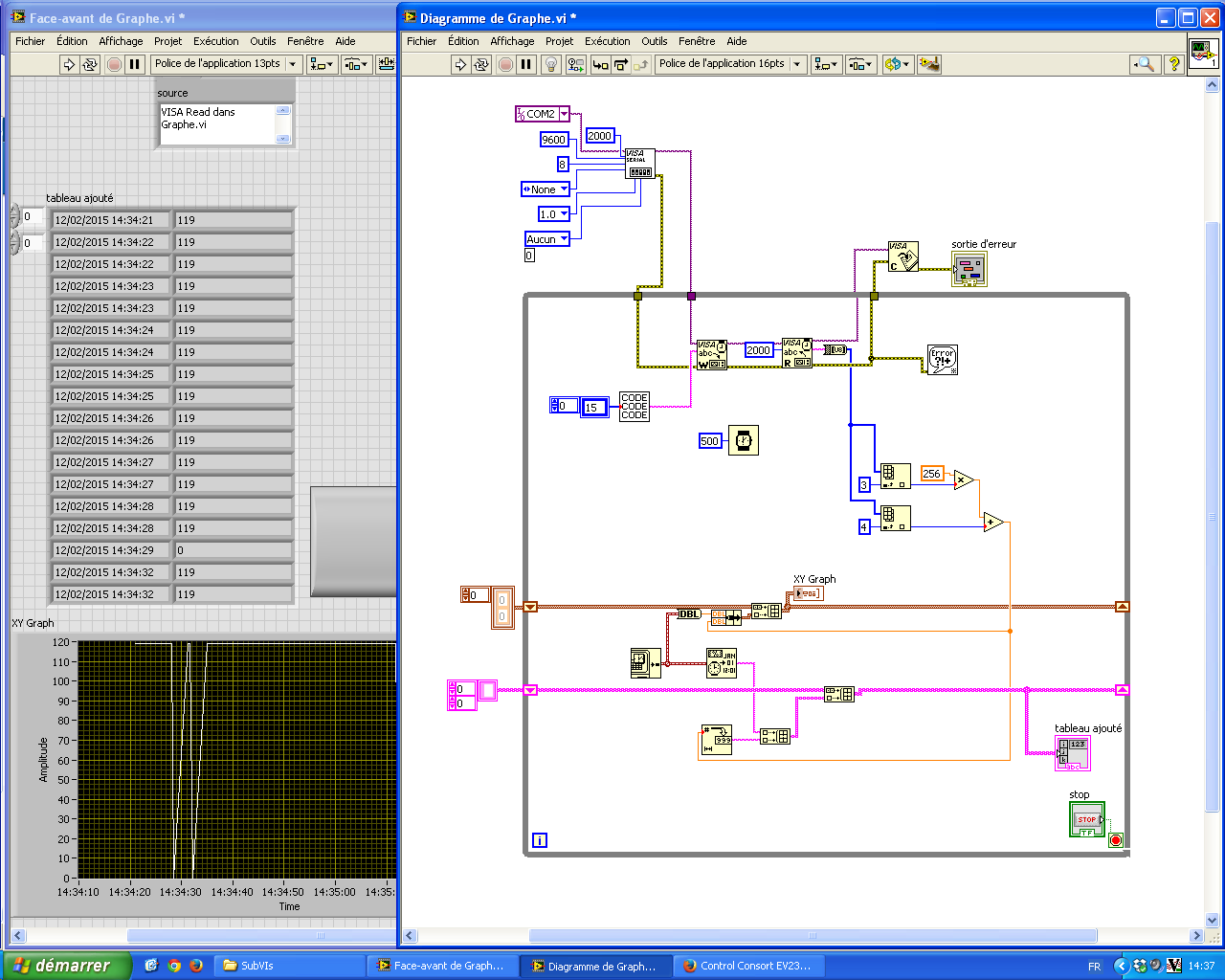

Another day, another problem: I've built this small code to test the measurement acquiring of the power supply. I use the code sent from the VISA Read to extract the value of the voltage and I plot it against time. Seems to work fine, but from time to time, I get a timeout error (I placed the Error Handler to tell me what's going on) and of course, the voltage read drops zo zero (as you can see in the graph in the lower left). This happens randomly. I'm pretty sure that the voltage itself doesn't drop to zero but that there's simply no code being returned from the power supply. Can anybody tell me why this is? This doesn't seem to have any influence on the running VI and I'm guessing it's something inherent to the power supply. So does anybody have any suggestions as how to go about acting as if there wasn't any answer that's supposed to come? To just skip the read and wait for the next one? (of course, I'd prefer to solve the problem instead)

One idea is to try drastically slowing down your data collection rate and seeing if you still get a zero every now and then.  Maybe 2s per reading kind of thing.  Just throw a timer on an error wire to make sure you are getting consistent delay between readings.
Use the OpenG libraries to get a timer that you can stick on an error wire.  Use the JKI VIPM to select all the openG packages and make them available in LabView.

I've raised the rate to 2 seconds, but the error still occurs. Sometimes, it would give me regular readings for about a minute, then there would be 2 consecutive misreadings, so really, it's pretty random. When using a timer count on an error wire, I can tell that the delay is consistent between the readings, but when there's an error, the delay is about 2 seconds longer, which is the timeout value I've entered to the VISA serial function.

It is pretty specialised. If not for the fact that we need very high voltage and very low current (< 1mA), I probably wouldn't have chosen to work with this one. Oh well. The software doesn't have the read measurements function... Nothing else seems to work, the errors really occur at random in a number of measurements.
I've noticed in the communication manual that they recommend resending the command if no answer is returned in max 0,5 seconds. So this is what I was thinking of earlier: "ignore the the reading if no answer is returned and just continue as if there hasn't been any query". Any thoughts on how to do that?
(Like, seriously, Consort anticipates this behaviour.)

Since it sounds like every sample isn't critical you could set your VISA timeout to some value slightly above your average successful sample time and if the reading is out of range average it in with the previous x number of valid readings.  Store the value on the way through the loop in a shift register say and then check it against an expected value and if it's outside of a given range then correct it.  If the timeout for your reading is only slightly greater than your nominal sampling rate you won't incur much of a performance hit.
It's a crude approach but would be my first move to get something up and going.

Oh well, I've done something similar: wired the error out of the VISA read to an if case structure. If there's no error, the graph is filled, if not, the wires go through without any manipulation. Works fine for the moment, I'll consider adding a range check later. It'll work anyways. Thanks a lot!
