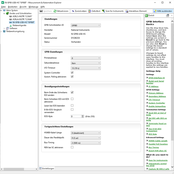

NI-488.2 version 2022 Q4 (serial number is prefixed with a 0, but no sign of the "this is a counterfeit product" warning)
It's working properly with a scope, and all the adapter, packaging, paperwork and CD stuff looks absolutely genuine (including a trail of matching serial numbers) except for one sticker on the cardboard box says "Baord". Well, and the fact that this GPIB-USB-HS is listed as PXIe-7862 after registering it via the popup window after driver install.
